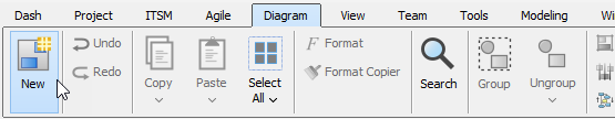

Step 1: Create a New Project and Diagram
Launch Visual Paradigm Desktop and select File > New Project to start a fresh workspace. Give your project a meaningful name, such as “Order Processing System DFD”.

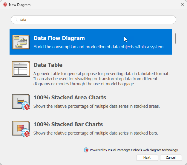

Once the project is open, go to Diagram > New from the main menu. In the New Diagram window:
  • Choose Data Flow Diagram under the Business category.
  • Name your diagram (e.g., “ATM Context Diagram – Level 0”).
  • Click OK to create the diagram.

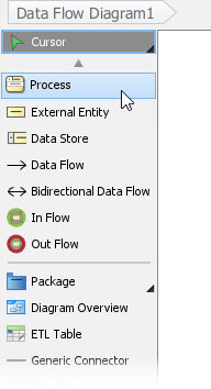

  1. From the Diagram toolbar on the left, drag the Process shape onto the canvas.
  2. Double-click the process and name it (e.g., “Order Processing System”). This represents your entire system boundary.
  3. Drag External Entity shapes (rectangles) from the toolbar and place them around the central process. Name them appropriately (e.g., “Customer”, “Supplier”, “Payment Gateway”).
  4. Use the Data Flow connector (arrow) to connect external entities to the central process. Label each arrow with the data being exchanged (e.g., “Order Request”, “Invoice”, “Payment Confirmation”).

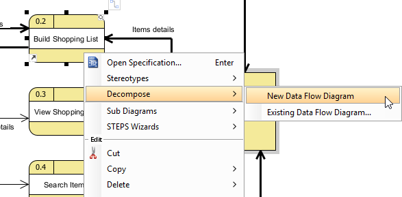

  1. Right-click the central process in the context diagram.
  2. Select Decompose > New Data Flow Diagram from the popup menu.
  3. Visual Paradigm automatically creates a new DFD and links it as a sub diagram.
  4. In the new diagram, replace the single process with multiple subprocesses (e.g., “Receive Order”, “Validate Payment”, “Generate Invoice”, “Update Inventory”).
